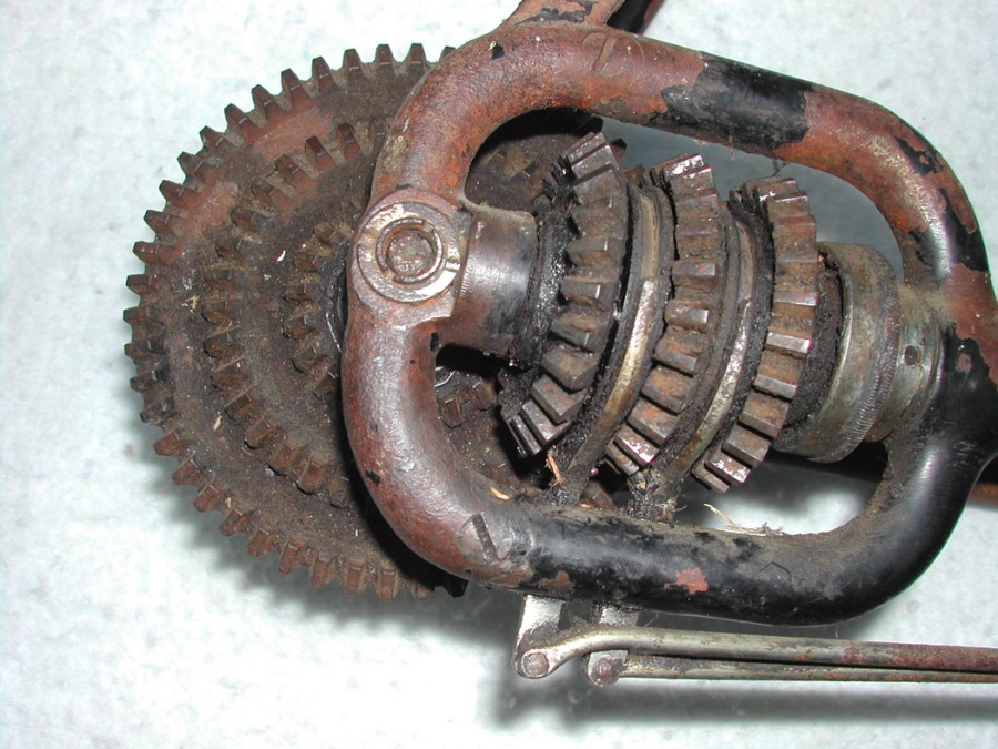

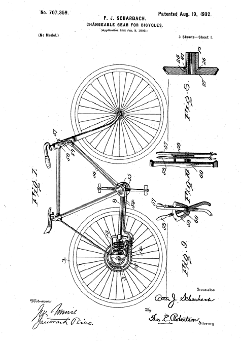

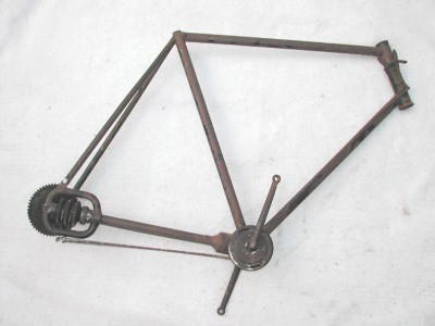

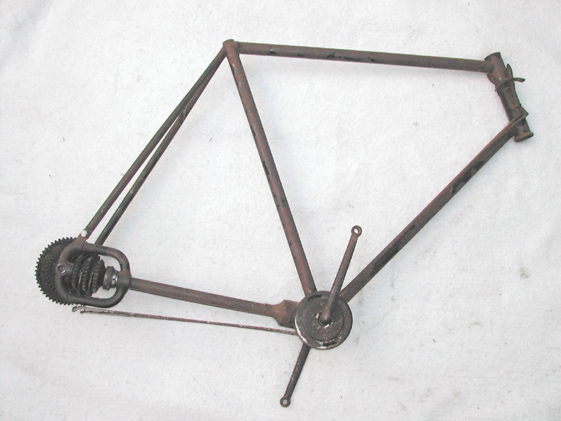

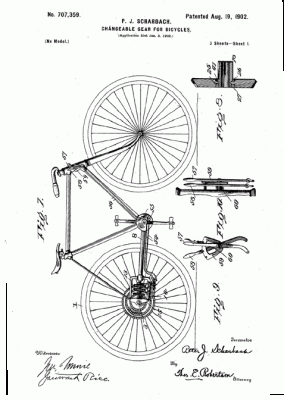

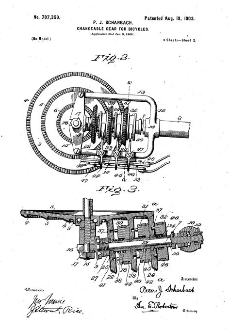

Kstati pervim seriynim velocipedom s mnogoskorostnoy KPP bul amerikanskiy kardanniy velik "Hill-climber". Vel bul osnachen kardanom i 3-x skorostnoy KPP. Ego proizvodili c 1902 po 1904 g.
http://www.womentalksports.com/items/read/63/36463
http://www.fusionstudios.com/hill-climber/
