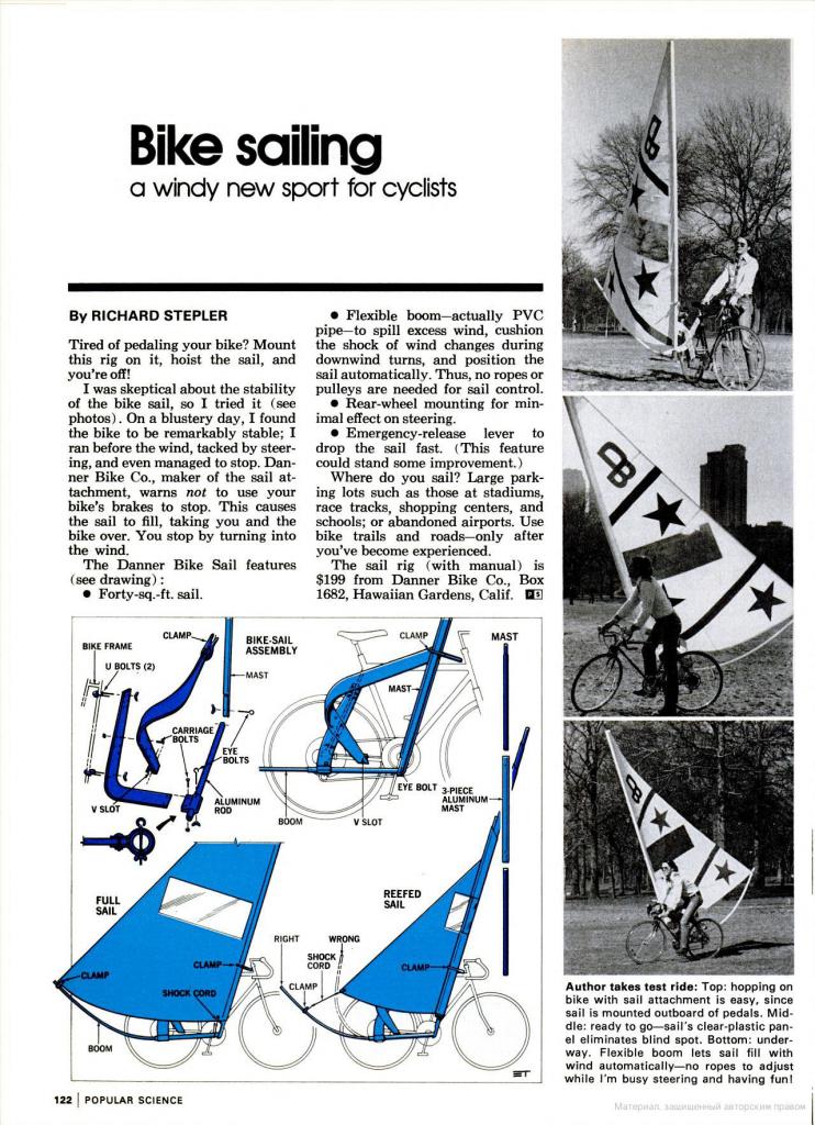

еще публикация.
Popular Science - Aug 1976 - Page 122
Bike sailing a windy new sport for cyclists
By RICHARD STEPLER
Tired of pedaling your bike? Mount this rig on it, hoist the sail, and you're off! I was skeptical about the stability of the bike sail, so I tried it (see photos) . On a blustery day, I found the bike to be remarkably stable; I ran before the wind, tacked by steering, and even managed to stop. Danner Bike Co., maker of the sail attachment, warns not to use your bike's brakes to stop. This causes the sail to fill, taking you and the bike over. You stop by turning into the wind. The Danner Bike Sail features (see drawing) :
• Forty-sq.-ft. sail.
• Flexible boom-actually PVC pipe — to spill excess wind, cushion the shock of wind changes during downwind turns, and position the sail automatically. Thus, no ropes or pulleys are needed for sail control.
• Rear-wheel mounting for minimal effect on steering.
• Emergency-release lever to drop the sail fast. (This feature could stand some improvement.)
Where do you sail? Large parking lots such as those at stadiums, race tracks, shopping centers, and schools; or abandoned airports. Use bike trails and roads— only after you've become experienced. The sail rig (with manual) is $199 from Danner Bike Co., Box 1682, Hawaiian Gardens, Calif.
Author takes test ride:
Top: hopping on bike with sail attachment is easy, since sail is mounted outboard of pedals.
Middle: ready to go — sail's clear-plastic panel eliminates blind spot.
Bottom: underway. Flexible boom lets sail fill with wind automatically — no ropes to adjust while I'm busy steering and having fun!

Популярная Наука - август 1976 - Страница 122
Велосипед, пересекающий под парусом ветреный новый спорт для велосипедистов
РИЧАРД СТЕПЛЕР
Усталый от езды на велосипеде Вашего велосипеда? Установите эту буровую установку на нем, поднимите парус, и Вы прочь! Я скептически относился к стабильности велосипедного паруса, таким образом, я попробовал его (см. фотографии). В ветреный день я нашел, что велосипед был удивительно устойчив; я бежал перед ветром, прикрепляемым, держась, и даже сумел остановиться. Danner Bike Co., производитель приложения паруса, предупреждает, чтобы не использовать тормоза Вашего велосипеда, чтобы остановиться. Это заставляет парус заполняться, принимая Вас и велосипед. Вы заходите превращающийся в ветер. Велосипедные особенности Паруса Danner (см. рисунок):
• Парус Forty-sq.-ft.
• Гибкий бум фактически труба ПВХ — чтобы пролить лишний ветер, смягчите шок изменений ветра во время подветренных поворотов и поместите парус автоматически. Таким образом никакие веревки или шкивы не необходимы для контроля за парусом.
• Заднее колесо, повышающееся для минимального эффекта на регулирование.
• Рычаг чрезвычайного выпуска, чтобы уронить парус быстро. (Эта особенность могла выдержать некоторое улучшение.)
Куда Вы приплываете? Большие автостоянки, такие как те на стадионах, круговых орбитах с прямолинейными секциями, торговых центрах и школах; или оставленные аэропорты. Используйте велосипедные следы и дороги — только после того, как Вы стали опытными. Буровая установка паруса (с руководством) составляет 199$ от Danner Bike Co., Коробка 1682, гавайские Сады, Калифорния
Автор берет испытательную поездку:
Вершина: прыгание на велосипеде с приложением паруса легко, так как парус установлен навесной из педалей.
Середина: готовый пойти — ясно-пластмассовая группа паруса устраняет мертвую точку.
Основание: в стадии реализации. Гибкий бум позволяет парусу заполняться ветром автоматически — никакие веревки, чтобы приспособиться, в то время как я занят, держась и весело проводя время!
