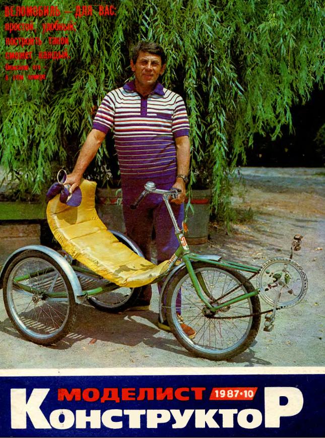

Da, v biblioteke v zurnale Modelisk-Konstruktor na oblozke uvidel velomobile Mazurchak :think:
Vmesto pustih zadnih koles ya reshil postroit' BOX dlia perevozki svoih svarochnih instrumentov.
U "mazurchaka" verhniaya chast' rulevoiy kolonki nikuda ne podsoedinena :lol: Nizniaya vilka vrode bi zakrita treugolnikom.
Tepereshnie analogi iz foruma Android, iz Australii "Cruz-bike" Ya absoliutno ne vosprinial ideiu Mazurchaka. Ya v 1voy medeli soediniaiu padal'nuiu karetku s verhneiy chast'iu rulevoiy vilki. DA DA tak-ze sdelan "Cruz-bike"
Eti moi "hozdeniya-po-mukam" proishodiat v 1987godu. Cherz 1 mesiats kataniy verhniaya chast' rulevoy vilki v meste rezbovoiy gaiyki razvalivaetsia. :think: ETO poishogit neozidanno. nago srochno ezdit' !!!!! Idey nikakih ......
Reshenie kopirovat' "mazurchak'a" Skopiroval, perevaril, poehal :violin: KAKiX eschio epitetov napisat' v Blagodarnost' Tovarischiu Mazurchaku? :angelic-whiteflying: :angelic-whiteflying: ???
