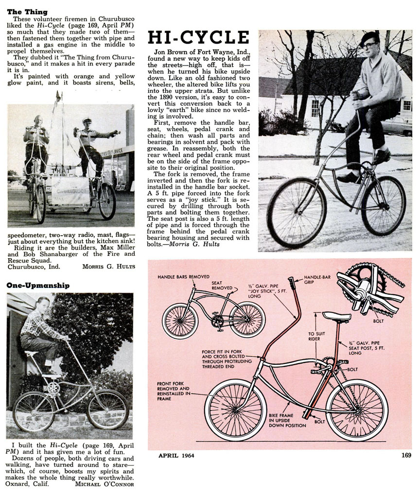

Popular Mechanics - апрель 1964 - Страница 169
HI-CYCLE.
Jon Brown of Fort Wayne, Ind., found a new way to keep kids off the streets — high off, that is — when he turned his bike upside down. Like an old fashioned two wheeler, the altered bike lifts you into the upper strata. But unlike the 1890 version, it's easy to convert this conversion back to a lowly " earth" bike since no welding is involved. First, remove the handle bar, seat, wheels, pedal crank and chain; then wash all parts and bearings in solvent and pack with grease. In reassembly, both the rear wheel and pedal crank must be on the side of the frame opposite to their original position. The fork is removed, the frame inverted and then the fork is reinstalled in the handle bar socket. A 5 ft. pipe forced into the fork serves as a "joy stick." It is secured by drilling through both parts and bolting them together. The seat post is also a 5 ft. length of pipe and is forced through the frame behind the pedal crank bearing housing and secured with bolts. — Morris G. Hults

I built the Hi-Cycle (page 169, April PM) and it has given me a lot of fun. Dozens of people, both driving cars and walking, have turned around to stare — which, of course, boosts my spirits and makes the whole thing really worthwhile. Oxnard, Calif. MICHAEL O'CONNOR

These volunteer firemen in Churubusco liked the Hi- Cycle (page 169, April PM) so much that they made two of them — then fastened them together with pipe and installed a gas engine in the middle to propel themselves. They dubbed it "The Thing from Churubusco," and it makes a hit in every parade it is in. it is in. It's painted with orange and yellow glow paint, and it boasts sirens, bells, speedometer, two-way radio, mast, flags — just about everything but the kitchen sink! Riding it are the builders, Max Miller and Bob Shanabarger of the Fire and Rescue Squad. Churubusco, Ind. MORRIS G. HULTS

Едут на фото сами строители, Макс Миллер и Боб Shanabarger из противопожарной охраны и спасения команды.

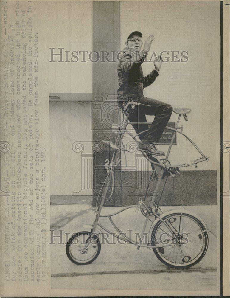

двойной hi-cycle... 1975 год

Осталось найти три рамы с орлёнка . Сварить их одна над одной ----и будет рекорд? Место в книге рекордов ещё не занято?

наверняка занято. Этот даже спиной вперед сидя на руле едет...
Но вот если наверху лежак сделать, самый высокий рекамбент типа, то можно и попасть в книгу. А то и сразу на премию Дарвина номинироваться.

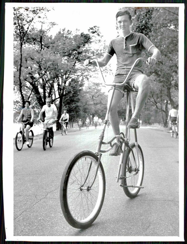

пресс-фото с ебея. Датировано 21 августа 1967 года.
На обороте надпись
AT BIKE TURNOUT-Jerry Smith, 16, 5056 Washburn Av. S., was riding one of the more unusual bicycles around Lake Harriet Sunday. His inverted frame bike put him up well above the crowd. More people pedaled along Lake Harriet Blvd. Sunday than rode along stretches of Victory Memorial Drive and W. River Road the previous Sunday, according to Luke Krmpotich, director of engineering and operations for the Minneapolis Parks and Recreation Department. He said that bicycles-only experiments will continue next week at another lake, possibly Lake Nokomis.
Конструкция выполнена по попмеховской публикации, приведенной выше, только велосипед с другой рамой. Поначалу подумалось что автор сделал его на раме свинг-байка (вообще чума). Есть подножка.
В принципе при добавлении рулю ещё одной степени свободы (на подъём например) можно связать его кинематикой на опускаемые колеса стабилизаторы по бокам. Тогда при остановках и на стоянке будет относительно безопасно стоять и спускаться.

С такого спрыгнуть в случае чего проблем не будет... Проблема в том что при такой длине руля он будет иметь иного степеней свободы и пружинить от небольшого усилия.
