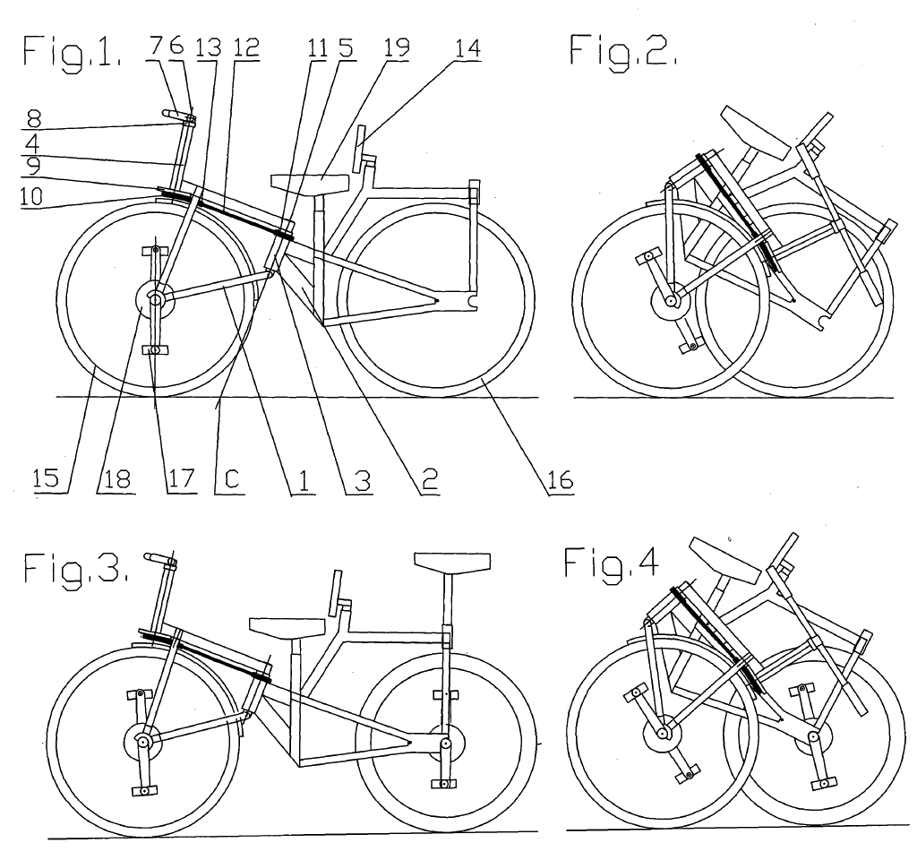

The subject of the invention is a bicycle with a drive on front wheel, which after turning the handlebar by cca 110 DEG relative to the frame of the front wheel considerably reduces its overall dimensions and which can be easily adjusted tor two persons. In this bicycle the train e consists of the frame (1) of the front wheel (15) and the frame (2) of the rear wheel (16), with the seat (19) and a back-rest (14) fixed.
Both frames are coupled with the joint (3) and the crossed line transmission (10, 11, 12).
In this coupling the axis of the joint (3) which is a part common to both frames intersects the floor surface in the point (C) at an angle of 69 DEG +-3 DEG , at a distance of 20+-4 cm behind the point of contact of the front wheel with the floor.
Applied drive system (18) is placed preferably on the axis of driven wheel, and it consists of the crank system (17), planetary transmission and the one-way clutch.
The handlebar (7) is mounted rotationally in the swivel axle (4) of the frame (1) of the front wheel and is immovably fixed through the swivel axle with the big wheel (10) of the crossed line transmission.
The swivel axle (4) of the frame (1) has two bearings (8), (9), where the bearing (8) at the handlebar (7) is a bearing of small friction momentum, while the bearing (9) at the wheel (1) of the transmission is a transverse slide bearing with big friction momentum.
The ratio of the crossed line transmission (10, 11, 12) equals to 1.4+-0.1:1.
The small wheel (11) of this transmission is immovably fixed to the frame (2) of the rear wheel (16) in the axis of the joint (3) coupling both frames (1), (2), and the big wheel (10) of the transmission is immovably joined through the swivel axle (4) with the handlebar (7) and rotates in the axis (6) of the swivel axle (4) of the frame (1).
The line (11) joining the wheels (10 and 12) of the transmission crosses between the big wheel (10) and two relief rollers (13) placed close to the wheel (10).

Предметом изобретения является велосипед с передним приводом является, что после поворота руля от CCA 110 & deg; по отношению к раме переднего колеса, значительно снижает его габариты и которые можно легко регулировать тор двух человек.
В этом велосипеде на поезде Конистон кадра (1) переднего колеса (15) и рамой (2) заднего колеса (16), с седлом (19) и спинкой (14) фиксированного.
Обе рамки в сочетании с сустава (3) и пересекли линии передачи (10, 11, 12).
В этом связи ось сустава (3), который является частью общей для обоих кадров пересекает поверхность пола в точке (С) под углом 69 + -3 DEG DEG, на расстоянии 20 + -4 см за точка контакта переднего колеса с полом.
Система (18) Прикладные привода предпочтительно размещают на оси ведомого колеса, и это Конистон коленчатого системы (17), планетарной передачи и односторонней муфтой.
Руль (7) установлен с возможностью вращения в поворотной оси (4) рамы (1) переднего колеса и неподвижно прикреплен через поворотной оси с большим колесом (10) линии передачи скрещенных.
Ось шарнирного соединения (4) рамы (1) имеет два подшипника (8), (9), где подшипник (8) на Руль (7) трения в подшипниках малого импульса, в то время как подшипник (9) в Колесо (1) передачи является поперечная Подшипник скольжения трением с большим импульсом.
Отношение передачи пересек линии (10, 11, 12) составляет 1,4 + -0,1: первый Небольшой колесо (11) этой передачи неподвижно прикреплен к раме (2) заднего колеса (16) в оси шарнира (3) сочетание обоих кадров (1), (2), и большое колесо ( 10) передачи неподвижно Регистрация через ось шарнирного (4) с рукоятке (7) и повернуть по оси (6) на ось шарнирного (4) рамы (1).
Линия (11), соединяющий колеса (10 и 12) Крестов передачи между Big Wheel (10) и двух рельефных валиков (13), расположенных рядом с колесом (10).
