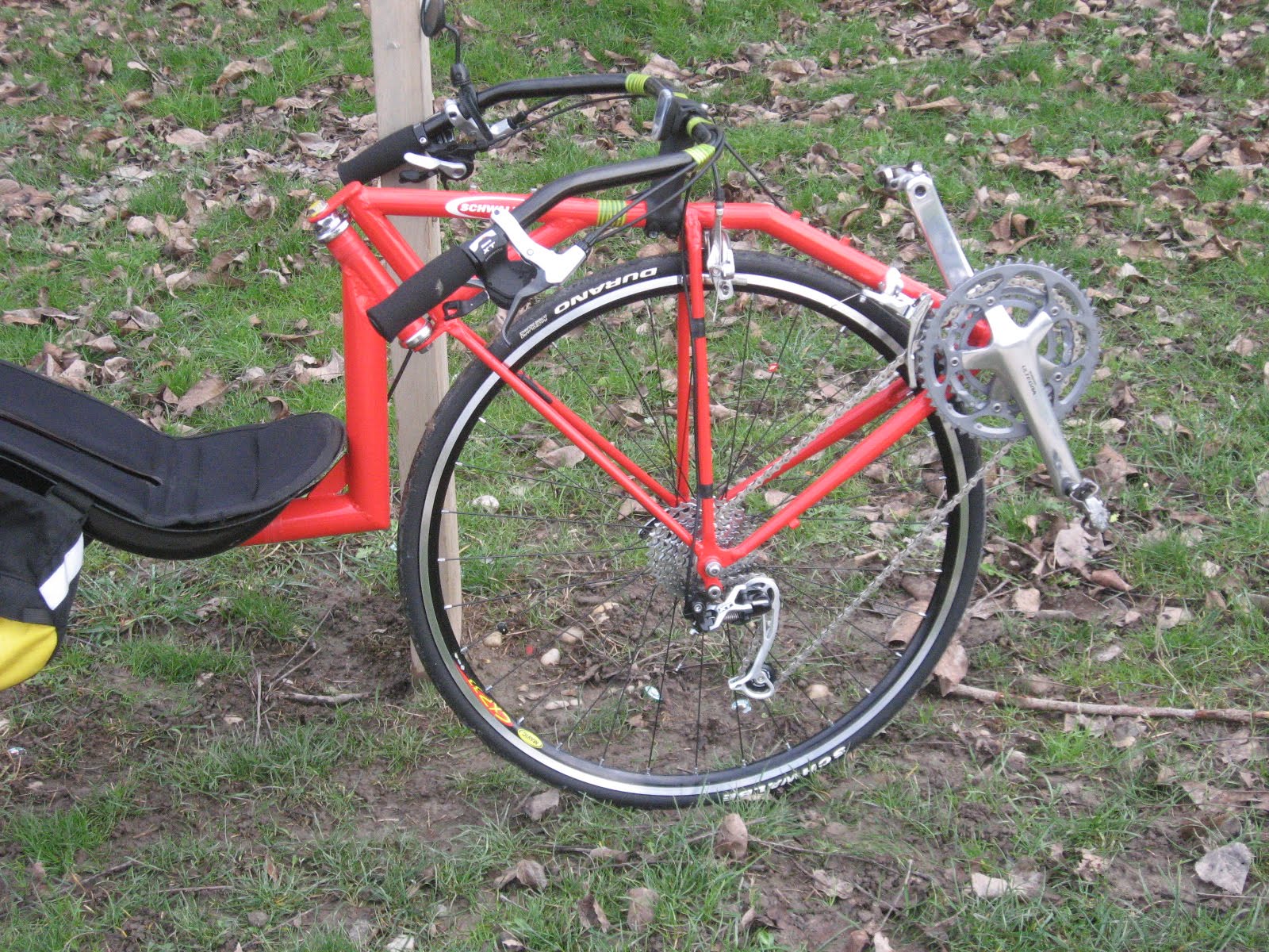

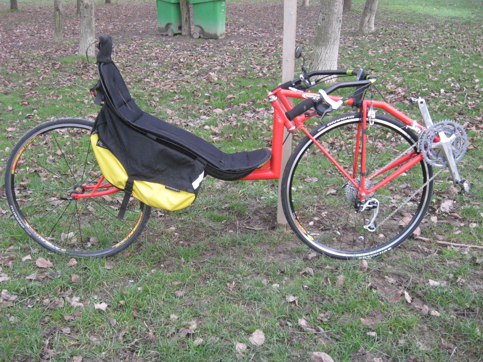

вот

Сложилось впечатление, что это удобная штука :) А есть отзывы о ходовых качествах? :wink:

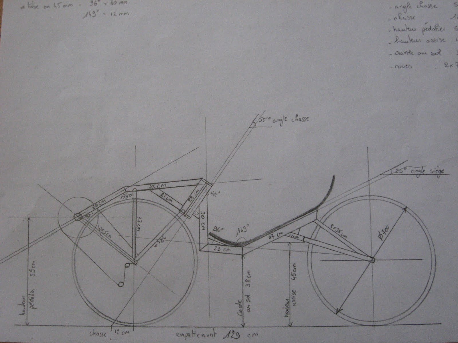

гугл переводчик говорит следующее:
"It's still light, a little cold (4 ° C), but I too wanted to try my new traction. So as usual, I go towards Miribel on a bicycle.
It's been too long since I made the bike to assess the performance of this bike, take the 52/14 is really hard in December.
By cons, this bike is designed for long distance and then I can say that the position is very comfortable, yet qq small adjustments to make and it will be perfect.
Unlike speculoos, we do not feel (or little) the irregularities of the road because of the wheels 700, it is a pleasure to ride on this bike. Moreover, with direct traction, there really is no sound except that of the freewheel (not pedal when I of course!). The steering is really different from Speculoos, it is higher, and the curves not go quite the same way. The sensation of speed is also lower.
In conclusion for the 1st test, I am very satisfied, I dropped the hands without worry, the bike is very stable, it runs really well, I just have to find a good physical condition to see what he has in the wheels.
It is Christmas and my gift arrived a little early.
As always, thanks to Zinzin the draft TD 700 (bike for long distance) came to an end and the result is really nice.
Seat Height: 47.5 cm
- Seat angle: 25 °
- Bottom bracket height: 54.5 cm
- Wheelbase: 123 cm
- Caster angle: 55 °
- Hunting: 11 cm
- Wheels 2x700
- Weight: 14 kgs (check) with pedals and a headrest.
- In Ultegra triple crankset
- Shadow XT derailleur
- AV RX100 brake calipers and Ultegra RD
- XT derailleurs shifters (push pull)
- Rear wheel Mavic Aksium race 2009
- Front wheel hub Mavic CXP33 Woodman (mounting Cyclociel)"

Неплохая конструкция. Видны вилка и жопа от стандартнойт рамы:) Но вписаны хорошо!

"В отличие от "Speculoos", этот велосипед практически (или только чуть-чуть) не ощущает дорожных неровностей благодаря 28" колесам, доставляет большое удовольствие катить на этом велосипеде. С передним приводом действительно нет шума трансмиссии, за исключением трещетки, конечно, когда я не кручу педали. Управление сильно отличается от "Speculoos" - красный велосипед выше и повороты на нем проходятся совершенно по-другому. Ощущение скорости также ниже.
В заключение первого теста скажу, что я очень впечатлен - я реализовал езду без рук без проблем. Велосипед очень стабилен, катит действительно хорошо, захотелось подождать физическое состояние получше, чтобы вкрутить на этом велосипеде по-полной и выяснить, чего он стоит."

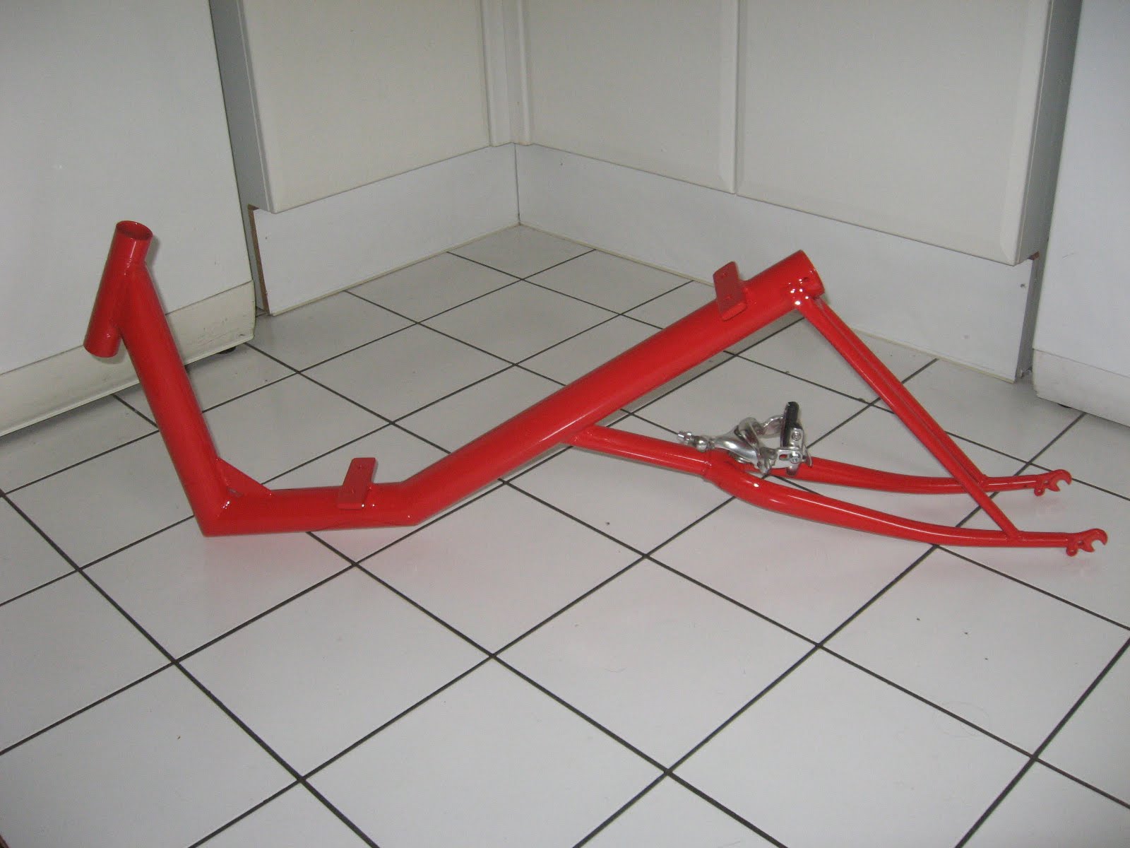

Основная какая труба?диметр?
 Заголовок сообщения: Re: переднеприводный лигерад-хайрейсер с углом 55
Номер сообщения:#16  Непрочитанное сообщениеДобавлено: Ср фев 03 2010 23:50
48х1 мм,
да, моя пойдет
да, можешь взять

48х1 мм,
да, моя пойдет
да, можешь взять
из чего ? какой сплав?
а есть 50х1 мм не чермет?
 Заголовок сообщения: Re: переднеприводный лигерад-хайрейсер с углом рулевой 55 гр.
Номер сообщения:#19  Непрочитанное сообщениеДобавлено: Чт фев 04 2010 01:54
30ХГСА
