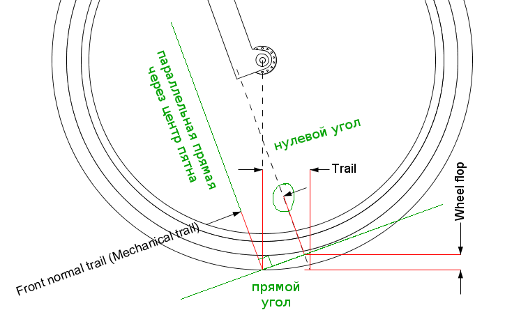

Так что насчёт указания величины флопа на чертежах?
https://www.bikecad.ca/node/18454
"Wheel flop is the vertical distance from the ground to the intersection of the steering axis and the mechanical/perpendicular trail measurement".
https://www.fxsolver.com/blog/2015/10/2 ... phenomenon
"Wheel flop refers to steering behavior in which a bicycle or motorcycle tends to turn more than expected due to the front wheel “flopping” over when the handlebars are rotated. Wheel flop is caused by the lowering of the front end of a bicycle or motorcycle as the handlebars are rotated away from the “straight ahead” position. Mechanical trail is the perpendicular distance between the steering axis and the point of contact between the front wheel and the ground. It may also be referred to as normal trail.
Wheel flop factor (f, in meters) the distance that the center of the front wheel axle is lowered when the handlebars are rotated from the straight ahead position to a position 90 degrees away from straight ahead, is depended on the trail and the head angle (the steering axis angle measured from the horizontal). b is the mechanical train (in meters), and θ is the head angle in radians"

lamplighter и к чему прилеплена эта "Wheel flop" на картинке ?
вот эта синяя стрелка - от чего до чего этот флоп ИЗМЕРЯЮТ ?
а, может быть измерение сиреневого параметра как раз таки важно?

Все как пишет Balor. Флоп - это разница между двумя конфигурациями. Разница выражается в изменении расстояния от земли до центра оси колеса. Первая конфигурация - при прямо смотрящей вилке. Вторая конфигурация - при вилке, повернутой на 90 градусов.
Еще раз: "Wheel flop factor (f, in meters) the distance that the center of the front wheel axle is lowered when the handlebars are rotated from the straight ahead position to a position 90 degrees away from straight ahead, is depended on the trail and the head angle (the steering axis angle measured from the horizontal). b is the mechanical train (in meters), and θ is the head angle in radians".

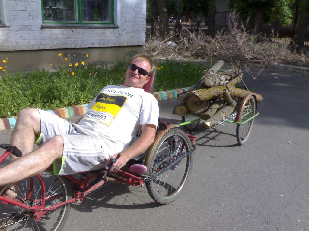

У кого это - у вас??? Для меня трайк - повседневный транспорт, и на работу, и на рынок, и в магазин...
Сможешь так на своем Ринзлере?

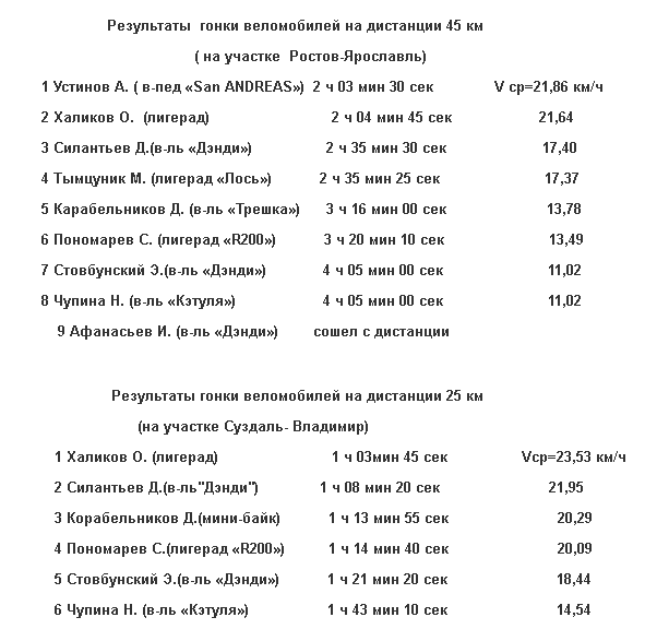

Ну что за враньё? Вот тебе официальные результаты 45 и 25 км гонок по реальным дорогам с нехилым набором высот в рамках тест-тура "Золотое Кольцо 2007":
Пруфлинк: http://etracab.ru/ofreztt2007.html
Напоминаю, что Денди - это лигерад-трайк на 12" колесах, оснащенный всего лишь тремя передачами с диапазоном 170 %.

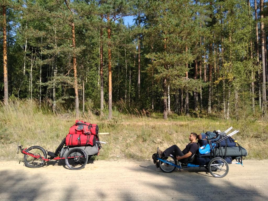

Про перевозку грузов напоминаю:

Ну что за враньё?
Не враньё. Сашка на своём подвесе вёз ребёнка, так бы ещё дальше оторвался.
А остальные участники, будучи семейными, просто "не вкатились": постоянная практика Тест-туров Ульяновского - на старт прибывают чуть ли не первым выездом на велосипеде в году. :roll:
По секрету скажу, ВВ любил преукрашать скорость веломобилей, мою тоже преукрашал,
Но мне от этого было только неловко.
В 2007 году, в первый день я был с вами, и это было ПЕРВОЕ знакомство с веломобилистами (КЭБ, Velomobile.nm) Прибыл на старт тогда ещё на шоссейнике ехали через Пушкино и по Ярославке на место лагеря, где мы с Аркадичем заночевали вдвоем в палатке.

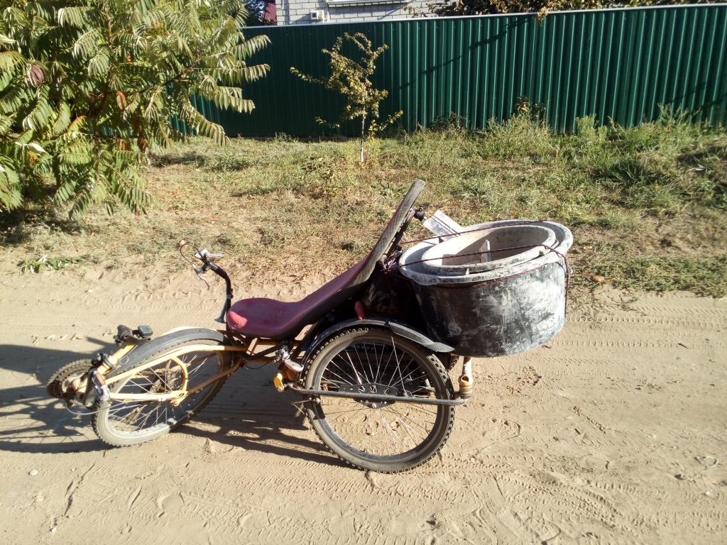

трайк сложен в ремонте со своими консольными колесами, дороже, больше габаритами.
Энергозатратнее, все ямы тремя колёсами ловит. По поводу "безопасности при лобовом столкновении", он НИЗКИЙ, и конечно же не 20-ти тонный трамвай...
Походит больше на инвалидку...
Именно.
И это кстати единственный путь в жизнь нашим оптимистам.
Единственные пару плюсов, устойчив и много можно увезти, но в россии большегрузы не популярны.
Да, или обуть в фэт резину и покорять Антарктиду/леса.
Или же грузы возить, как Олег Белый, в спокойном и размеренном ритме жизни города Калач.
Кстати, уже в ближнем Подмосковье можно увидеть всякие мотоблоки с телегами, ездящие с жуткой копотью 10км/ч.
То почему бы и на трайке не повозить грузы? :) Кудаиполезнее и экологичнее.
